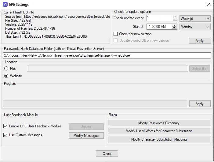

EPE Settings Window

Configuration Settings​
Click Configuration > EPE Settings on the menu to open the EPE Settings window.
The EPE Settings window is only available to Threat Prevention administrators.
EPE Settings window
The window displays current hash database information and has the following configuration settings, displayed in sections on the window.
Current Hash DB Info​
The Current hash DB Info area is enabled after the HIBP database has been deployed to Enterprise Manager for the first time. It displays the source from where the database was downloaded, its size, version, and the number of hashes it contains. It also shows a thumbprint value that changes whenever the content of the Hash DB changes.
tip
Remember, the HIBP dataset is updated at random intervals by its publisher. It can go weeks or even months with no changes.
Check for Update Options​
The Check for Update options area specifies when the Netwrix website is checked for a new version of the HIBP database.
These options are enabled after the HIBP database has been deployed to Enterprise Manager for the first time.
Configure the following options:
  • Check update every [number] [unit of time] – Select how often the Netwrix website is checked for a newer version of the HIBP database
  • Start at [time] [day] – Select the time and day when Threat Prevention will check the Netwrix website for a newer version of the HIBP database
  • Check for new version – Checks the Netwrix website for the latest password hash file details and compares the SHA-1 to the local hash file to determine if the website has a newer version of the HIBP database. If only this option is selected, then an alert is generated in the Administration Console when a new version is detected.
    This checkbox doesn't automatically download the new HIBP database version.
  • Update pwned DB on new version – Checks the Netwrix website for HIBP updates and then updates the Enterprise Manager server if a new version is detected
After making selections, click the Apply button to enable checking for updates at the scheduled intervals.
Passwords Hash Database​
Threat Prevention uses the Passwords Hash database to check if users’ new and pending password (i.e. during a password reset) matches the hash of a compromised password from a data breach.
First-time configuration of this window requires downloading the HIBP database from the Netwrix website. If the Administration Console doesn't have internet access, see the Download and Configure the Have I Been Pwned Hash List topic for instructions.
Ensure the initial update of the database occurs during non-office hours. Due to the size of the hash file, this download takes up a significant amount of CPU and download time.
  • Passwords Hash Database Folder (path on Threat Prevention Server) – Central location of the Pwned database on the application server. The default path is:
…\Netwrix\Netwrix Treat Prevention\SIEnterpriseManager\PwnedStore
