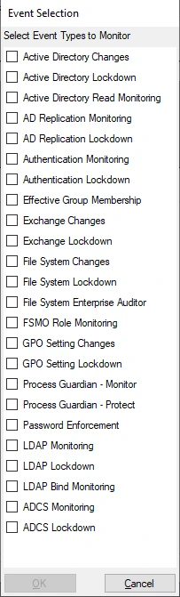

Each event type represents what is monitored or blocked. Event filters are used to either narrow or broaden the scope of the monitoring/blocking as desired. Click Add (+) to open the Event Selection window. Your licensed modules determine what event types are available. Event types that are not available or not licensed are grayed-out but visible in the Event Selection window. See the License Manager Window topic for information.
Event Selection Window
Check the box for the desired event type and click OK. The corresponding event filters show at the bottom of the Event Type tab. Multiple event types can be assigned to a policy.
